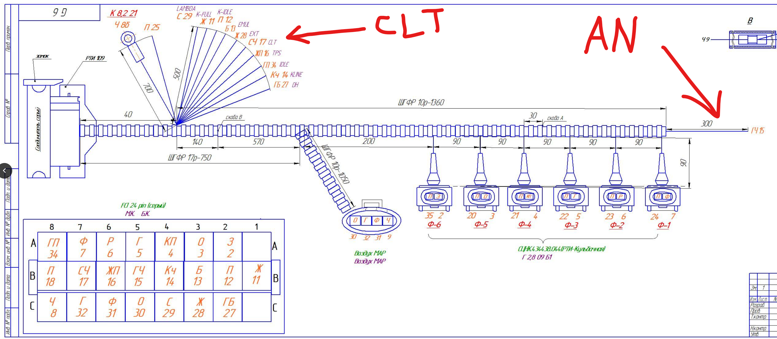

Hi, since on the guide the wires are named differently than in the kit, I'm asking you if I'm doing the wiring correctly.
I've tried to read the russian forum but translated makes no sense at all.
Engine m102 1.8e 25 pin ecu
1- 12v
2- GND
3- IDLE
5- K-FULL
8- LAMBDA (i don't have lambda so i need to install it)
13- K-IDLE
20- GND
21- CLT
25- AN
DH to ground
now the issue is, what are the AN and CLT wire? i can't find them in the invent harness.
I have watched this video on youtube https://www.youtube.com/watch?v=xzhlwHUr84s&t=1s but i can't understand what is he saying :cry_ing:
Thanks in advance
Hi!
Yes, wiring is correct
Please check drawing, I've marked CLT and AN wires:
