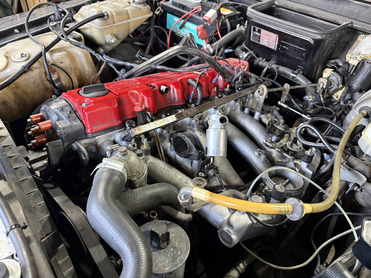

I have found the correct manifold. The partnumber is R 103 141 16 01 or 1031411601 this one has 18mm injector holes. The rest of the manifold is exactly the same.
I have cut and fit the injectors and rail. They fit well. Placement of the connector for the fuelhose is not the best. It is now right between the throttle linkage. Would probably be better somewhere in the middle or at the very end?
I dont intend on putting the rubber boot back on the intake. I’m just going to put an aluminium intake pipe with a filter on the throttlebody.
IAC is also annoying, i dont understand why it needs such a big hose! I have to figure out a good way to mount it.
