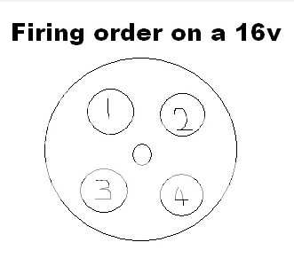

Maybe it is a timing issue? I am sure that the sequence is correct. Picture:
But how do I set the timing now that it will only run for 0.5 seconds? Just crank it and use a stroboscope?
