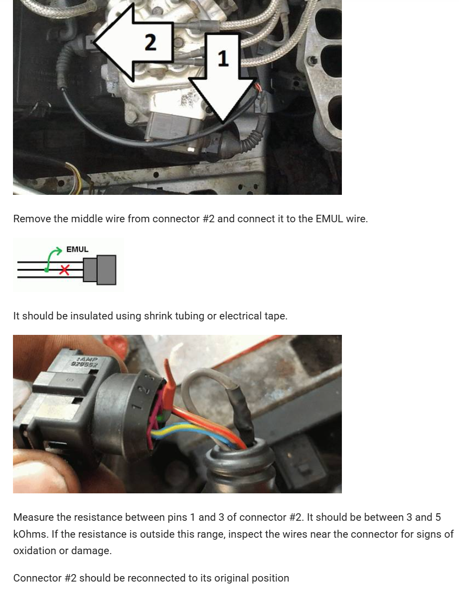

Hello there, i have a quick question regarding connector #2 in the manual for Audi 2.3 NG. Is it a must do to reconnect connector #2 or is it sufficient to connect the EMUL wire? I want to remove the whole KE-Jetronic and not only remove the baffle plate inside.
I understand that i need to keep the pressure actuator and connector #1
