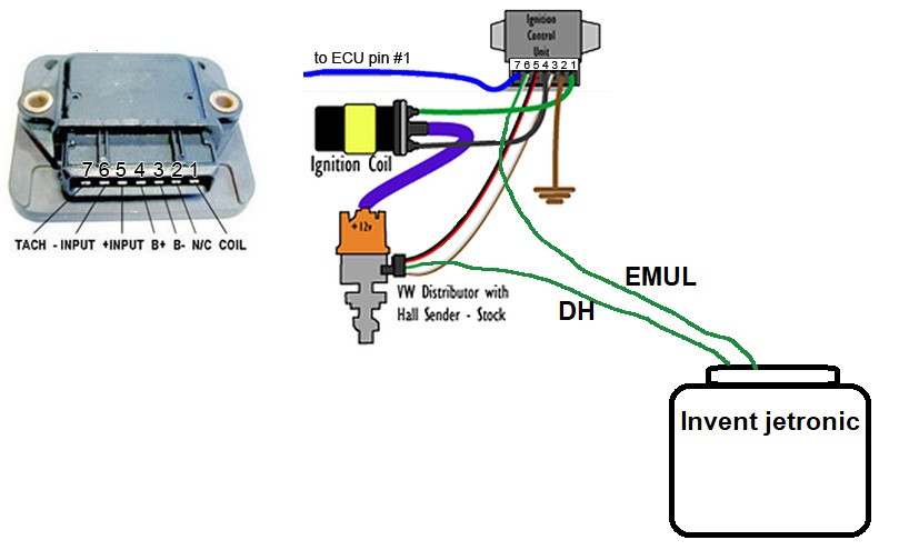

Hi, I'm having some trouble, trying to use Invent jetronic ignition control on Audi 80 2.2 KK engine. It has a distributor with vacuum and old fashion ignition module (no stock ecu).
What I already did:
Replaced distributor which doesn't have vacuum and upgraded it for phase injection.
Cutted middle wire from hall sensor when connected DH wire to hall sensor and connected EMUL wire to ignition amplifier signal wire.
I entered the settings into the control unit as described in manual (ignition control).
But I have no spark. can't start engine. Is it I connected something wrong or I missed something? need some Help. Attached pic how I connected DH and EMUL wires.
P.S. If connect DH wire in parallel to the central wire of hall sensor connector when I have spark and engine runs, but when I have no ignition control.
